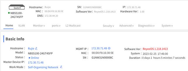

l  After an upgrade to the new version, navigate to Eweb> Local>Home>Basics to verify the version information, including the software version number, SN and model. See Upgrade Procedure for details.

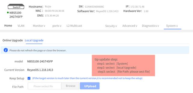

1.4   Upgrade Procedure
l  Connect the device with a PC and configure the PC with an IP address in network segment 10.44.77.10/255.255.255.0.
l  Power on the device. After the system LED turns solid on, open a browser, enter 10.44.77.200 into the address bar and press Enter.
l  Log into the system and complete wizard configuration.
l  Navigate to System>Upgrade>Local Upgrade. ClickBrowse, select an upgrade file (e.g., SWITCH_3.0(1)B11P218_NBS5000_10141309.tar.gz) and clickUpload. After an upgrade to the new version, verify the version information.

1.3.2 Check Version
