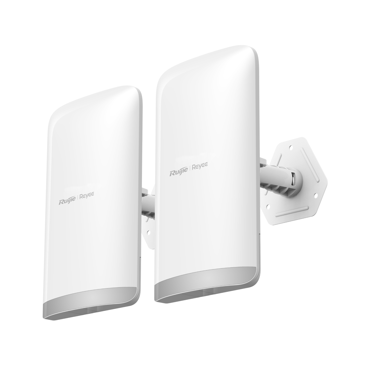

RG-EST350 V2, 5GHz Dual-stream 802.11ac 5KM Wireless Bridge (Pair)
Factory, Surveillance, Transportation, etc.
  • RG-EST350 V2 can easily transmit data from 5KM away in real time
  • Factory-paired bridges for long-distance installation, without complex alignment
  • IP54 Weatherproof, -30℃~65℃ guarantee stable operating
  • Support maximum 45 * 2MP cameras loading at 3KM, 20 * 2MP cameras loading at 5KM
  • Visually Intuitive statistics monitoring on Ruijie cloud, easy maintenance at remotely
RG-EST350 V2
5GHz Dual-stream 802.11ac Next-generation Wireless Bridge
5GHz 2x2 MIMO
2 x GE Ports
Long Range
High-speed wireless data transmission at 5KM range
867 Mbps
PTP/PTMP
5KM Operating distance
High Capacity
45 cameras maximum at 3KM, 20 cameras maximum at 5KM*
*H.265, 2MP Cameras, 3Mbps. To guarantee the transmission quality, the environment should be kept as open as possible to reduce the interference.
At the same time, it is recommended to adjust it to the best alignment angle with the signal strength indicator or Ruijie Cloud APP.
Reliable
V0 level
flame retardant
IP54
Weatherproof
-30~65℃ operating
temperature
Convenient
Zero configuration automatic pairing
Plug and Play
Easy to Install
